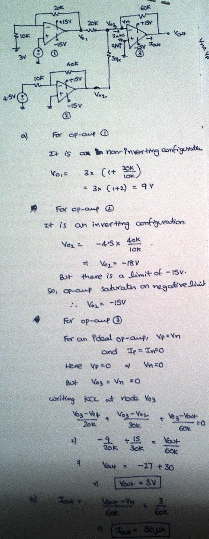

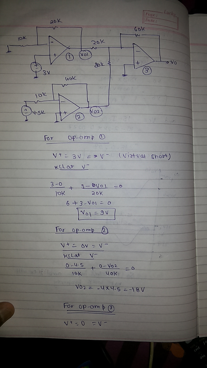

(I changed it to ask only one question at a time) Hi everyone. At my school we are allowed to do test corrections for the midterm. The following is the five questions on my exam along with my solutions. We have to have all solutions perfect to get credit and we are allowed to get help. Could you please check my work and let me know if I have made any mistakes?
Problem 1:
Solution 1:

Look at the final opamp plus the three resistors connected to it. What classic opamp circuit do they implement?

Hmm, I show you the correct answer
Vo1 = 3V * (1 + 20K/10k) = 9V
Vo2 = 4.5V * -(40k/10k) = -18V but because negative supply voltage is -15V the Vo2 voltage cannot be lower then -15V. So this mean that op amp is in negative saturation and Vo2 = -15V.
Vo3 = 9V * -(60k/20k) + (-15V)*-(60k/30k) = 3V
Iout = Vo3/60K = 50μA
And now if we change Vin1 = 4.5V into 0V Vo3:
Vo3 = 9V * -(60k/20k) = - 27Vand again we have a op amp in saturation, but this time IC3 is in saturation, so Vo3 = -15V

Break the problem down into modular pieces.
You have two input signals and three opamp circuits. The two inputs are V1 and V2. As shown, V1=3V and V2=4.5V.
The first circuit, OA1, acts on V1 only:
The second circuit, OA2, acts on V2 only:
And the third, OA3, acts on the outputs of the first two:
These three circuits are connected as follows:
Take each circuit in turn and forget about the others. What type of circuit is it? What is the output of the circuit in terms of the input(s)? What are the limits?
Then combine these results to yield the overall circuit equation. At this point you have a nice generic solution for any set of input voltages. Now you can just plug in the voltages needed for a given part of the question and get your answer.
