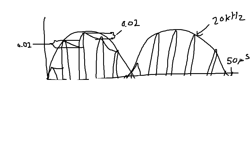

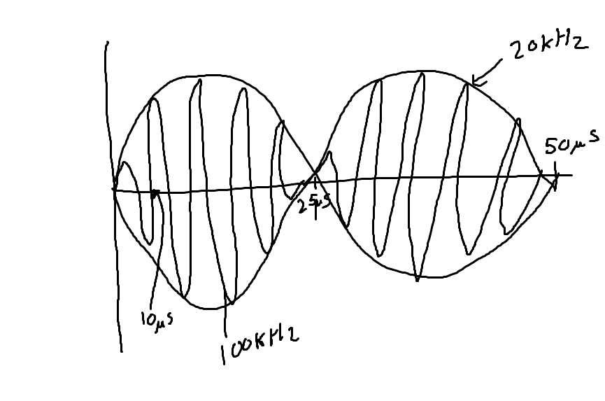

I am unsure how this filter works (i am in an intro to analog circuits class and we barely covered active filters).
Here is my attempt at drawing the input voltage:
you can see I used the 20KHz wave as an envelope for the 100Khz signal, drawing 5 full waves of the 100KHz within one half wave of the 20KHz, but i am not fully sure if this is the correct thing to draw as i have never worked with overlapping signals...
As for the voltage at the point specified, i believe that all that does is cut off the bottom portion of what I drew as well as decrease the voltage by 0.7 volts (The standard voltage drop of a diode). But i am not sure if this is correct.
For part B I have no clue how to approach this. I didn't know this filter had gain, i thought active filters just filtered...
EDIT: For part a i just realized that there is a capacitor acting as ripple control, so the output should not just be the top half of the input, but how do i calculate this ripple control? I know that delta V = I_load/fC for this half wave recitifer, but is Iload the entire rest of the circuit or is it just the next resistor?
Still super confused about part b, i know that DC level frequencies get eliminated because of the capacitor in the middle, but how do i determine the cutoff frequency? The op amps seems like all they are doing is buffering the signal and not actually filtering it.
EDIT 2: I just realized my scaling is off, i should have 2.5 waves of the 100KHz within on half wave of the 20KHz, so 5 waves total over the full length of the 20KHz.

Remember your virtual ground principle. One end of R1 is connected to an op-amp input that is at________________________.
I_load must be E/R. What is your rectified voltage going to be if you assume no impedance at Vin (the signal source)? Run the math for ripple voltage now.
and, yes. It doesn't look much like a filter with the frequencies given.

the op amp input is at ground, so all the voltage drops across R1.
I_load must be E over R, what is E here? My rectified voltage is going to be Vin-0.7 because 0.7 is the diode voltage drop and Vin is 2Volts peak to peak, so after the diode drop it is 1.3 volts peak to peak so Vmax is 1.3/2 = 0.65V. I dont know what you mean by "no impredance at Vin"
assuming I have made the right decisions then I_load = 0.65V/1,000 = 65 microAmps?
So our ripple voltage drop delta V = 65microAmps/(100,000 Hz * 0.015 microHenris) = 0.0433 Volts.
So does that mean that at the peak of each of the rectified waves it will fall off 0.433 volts until it hits the next wave and gets brought back up to Vmax?

Part 1: true.
Part 2: 2 volts (peak to peak), rectified is not 1.3 volts or 1.3 volts divided by 2. After the diode, the entire negative half is missing and you have some .3 volts of the positive half remaining. and you typed the resistor value wrong. R1 is 10,000 not 1,000 The math is right, the typing is off. Then the .015 is micro farads, not micro henris.
all the rest: true.
As for source impedance: If the 2 volts (peak to peak) was arriving through a one million ohm resistor, it would make a lot of difference in the answer, so we assume the 2 volts is arriving from a source with no resistance in the path.
And, finally, if your teacher decides the diode only uses up .6 volts, he will think you are wrong, but you seem right to me.

So let me run these numbers through.
after the diode rectifies the signal it is .3 volts at its peak.
So the Iload is 0.3/10,000 = 0.3mA. Then the delta V =0.3mA/(100,000*0.015microFarads) = 0.02Volts.
So if i drew it it would look like this

Your numbers are right. You need to get rid of that outer envelope line and remember that there are only 2 1/2 of the fast waves per half cycle. Then remember that there is a time gap where the 2 1/2 waves going in the negative direction don't exist.
tbinder3
Joined Jun 30, 2013
30
Between the two "humps" you will have a time gap where the negative part of your sinusoidal wave would've been.
So draw the wave like it should, erase the negative part, your good to go. I thought your other graph looked better than this more recent blob of nothing.
