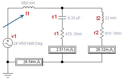

I need a help to understand where is the mistake in my SPICE (programm: SPICE 2G.6) netlist. I have drawn an average-complexity (as for me) AC a circuit to test myself, and calculated everything what I have learned (except power), every property (voltages, currents, and their angles), but those values seems to be incorrect. However, when I check my circuit with EWB (programm: Electronics Workbench Version 5.12), it says me that everything is okay. But SPICE tells me that I am completely wrong! :confused:
Some images are too big for this forum, so I will paste links to them.
Here is my drawn circuit with netlist:
http://i42.tinypic.com/2i1cc29.jpg

Here is the netlist:
circuit
v1 1 0 ac 24 sin
vit 1 2 ac 0
vilr 3 4 ac 0
vicr 3 6 ac 0
l1 2 3 560m
l2 4 5 22m
r1 5 0 470
c1 6 7 .33u
r2 7 0 910
.ac lin 1 50 50
.print ac v(2,3) vp(2,3) i(vit) ip(vit)
.print ac v(4,5) vp(4,5) i(vilr) ip(vilr)
.print ac v(5,0) vp(5,0) i(vilr) ip(vilr)
.print ac v(6,7) vp(6,7) i(vicr) ip(vicr)
.print ac v(7,0) vp(7,0) i(vicr) ip(vicr)
.print ac i(vit)
.end
Here is what SPICE tells me:
V(2,3) VP(2,3) I(VIT) IP(VIT)
8.544E+00 7.107E+01 4.857E-02 -1.893E+01
V(4,5) VP(4,5) I(VILR) IP(VILR)
3.340E-01 6.831E+01 4.832E-02 -2.169E+01
V(5) VP(5) I(VILR) IP(VILR)
2.271E+01 -2.169E+01 4.832E-02 -2.169E+01
V(6,7) VP(6,7) I(VICR) IP(VICR)
2.261E+01 -2.623E+01 2.345E-03 6.377E+01
V(7) VP(7) I(VICR) IP(VICR)
2.134E+00 6.377E+01 2.345E-03 6.377E+01
I(VIT) <------------------------| total current
4.857E-02

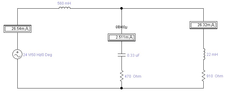

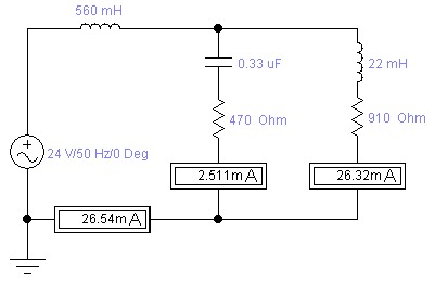

And here are the EWB results for currents only, and that is enough for me for thinking that I am on the right way:
What do you think? :rolleyes:

I do a I quick calculation check of your and this is what I find
Ztot = XL1 + ((Xc1 + R1)*(XL2 + R2))/((Xc1 + R1) + (XL2 + R2)) = 899.226 + j98.4753
Ztot = 904.602Ω
and
Itot = 24V/904.602Ω = 0.026531A = 26.531mA
And
Ic1 = 0.00247957A = 2.47957mA
IL2 = 0.0263132A = 26.3132A
