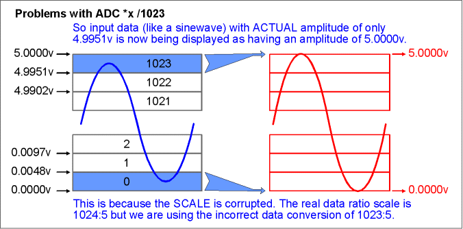

Understanding the *x/(n-1) problem.
The problem with /(n-1) is that it corrupts the SCALING of data. Because it forces the top ADC unit value to be the top of the scale the scale no longer is an accurate conversion of data.
This corruption means the true scale of 1024:5 is being represented as 1023:5 so the data on the output is now larger than life;
However if the correct scaling is used; ADC*5/1024, then any input data is correctly represented at the output;
All data is rounded down to the nearest ADC unit, so all the output data is correctly scaled but will have an average error of -0.5 ADC units.
This error is actually a property of the ADC module hardware AND the ratio scaling math. This is because the ADC hardware rounds all voltages down to the nearest ADC unit, and because the integer division (/1024) also rounds data down. (More on compensating for this later).

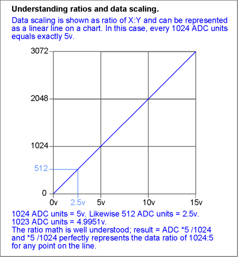

Understanding ratios and ratio math!
A ratio is one scale compared to another. The result can always be calculated as *x /y (or *y /x) and will always appear as a linear line on a graph.
Forget ADCs for the moment and let's look at ratio scaling two other real world scales. For instance scaling Hz to RPM. The ratio is known; 1 Hz = 60 RPM, so the ratio is 60:1 and we can convert Hz to RPM by doing the math; Hz *1 /60 = RPM.
This math will give perfect scaled conversion of Hz to RPM. Note that there is NO correct solution using /(n-1) and *1 /59 will NOT properly convert Hz to RPM!
With a PIC ADC module there are exactly 1024 ADC units (numbered 0-1023) for every 5v. The ratio
to calculate voltage from ADC units is 1024:5 and that ratio is performed with this math; *5 /1024.
This ratio can be shown as a graph;
If the ADC happens to have 11bits (has 2048 ADC units) and runs from 10v the ratio remains the same, as the relationship of ADC units to voltage is still 1024:5.
Doing the incorrect math of ADC *5 /1023, gives ONE advantage, it means that the top ADC reading of 1023 will give an output result of "5v". The problem is that doing this kludge in code gives incorrect scaling of ALL the ADC data by adding more +error to the data as the values increase;
In some cases you may be able to tolerate this error, if you don't mind the two problems;
Problem 1. Higher values are always rounded up, lower values are always rounded down.
Problem 2. The output data (waveforms etc) are shown to be larger than reality (scaling error).
