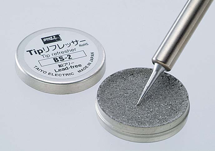

Hi everyone,
I bought a new soldering tip a couple of days ago (cone shaped one, pointy tip), and already about 40% of it is blackened. The solder will not melt on those parts.
Also, the very very tip of the soldering tip is blackened, which makes it near on impossible to solder small components.
Why did I do to create the blackening? How can I avoid it? :(

I'd recommend using a brass scourer like this:
http://uk.rs-online.com/web/p/soldering-station-accessories/0203410/
they clean the tips really well. Also get yourself as little tin of tip cleaner like:
http://uk.rs-online.com/web/p/soldering-iron-cleaning-accessories/0226287/
it is solder paste mixed with some kind of agrressive flux. Get the tip nice and hot, plunge it in and all of the crap gets removed from the tip. it does generate some pretty unpleasant smoke though.
I think I've seen someone using that stuff. It is semi-transparent right? And it looks a bit like jelly. I noticed that when he stuck his soldering iron in there, lots of black stuff came off. Perhaps I should get something like that.

What you've seen is pure rosin paste flux. The tip cleaner has a grey look to it and is a bit more firm than the jelly consistency of rosin flux. They come in small tins, and are only to be used when your tip is in the condition yours is in. When purchasing a tip cleaner, be sure to get the tin/lead tinning mix, and NOT the lead free mix.
