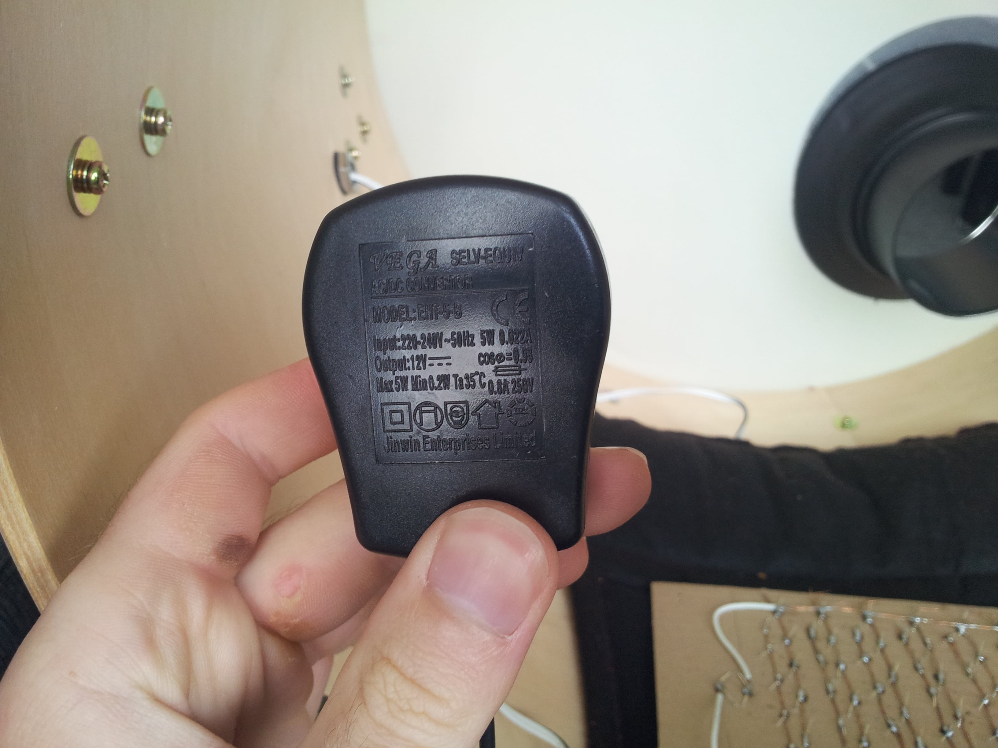

OK - this is what I did, I am aware it is deemed wrong by many people so not looking for too much feedback on why it's wrong. I just need to know how to do this correctly and so that all the LED's are as bright as they can be, even if it means buying a better DC transformer from Amazon UK.

please remember - I am a total beginner, this was a test to see if it worked. The LED's used are 3.4 Vf 0.022A White colour.
elec_mech
Joined Nov 12, 2008
1,500
What is the voltage and current (or power - wattage) of the supply you are using for your pictured test circuit?
First, nice job on the diagram and your circuit. Very clean. It will need to be modified to work long-term - I understand you're new to this, so please understand this isn't meant to be mean or spiteful. You've asked for help and that's what we're here for. :)
So when working with LEDs, it is important to limit the current going to them otherwise they'll take in too much and eventually, if not immediately, burn out. You do this by including a current-limiting resistor in series with one of the LED's legs; it does not matter which one.
I didn't get into a lot of details with my suggestion, so let me elaborate. If you put LEDs in series, you add up the voltages of each LED to get the total required voltage to drive them. This also means one current path for the set and thus only one resistor is needed to be placed in series with the set.
You generally work backwards by first starting with the available power supply(-ies) you have available. In this case, I only saw one DC supply and chose it. It is rated at 12V. So, if I put two LEDs in series, I need at least 3.4 x 2 = 6.8V to drive them. Remember you must have a current-limiting resistor, so that means you'll need some overhead - in other words a higher supply voltage. You wouldn't, for example, use a 6.8VDC supply if you could find one.
So, 12V-6.8V = 5.2V. Since your LEDs need 22mA, you need V = IR -> R = 5.2/0.022 = 236Ω or a commonly found 270Ω resistor in series with the two LEDs to act as a current limiter.

Elec-mech. Thank you for that reply, it made a lot of sense. The transformer I used was the 12v one you used in your calculations. However it is a 5w transformer and apparently will not power the circuit I have in mind. So without sounding cheeky, can you please explain how it is fine to use that exact transformer pictured? More for my own understanding.
Do you mean the 70 LEDs or the 40? You originally said 40, so this is what I was basing my calculations on.
You are correct, the 5.18W will really push the 5W transformer. If you want to use it to test your circuit for a minute or two, you should be fine, but I wouldn't use it for more than that.
The 60W sounds like a winner. As wayneh already mentioned, yes it will power a single LED as long as you use the right resistor.
