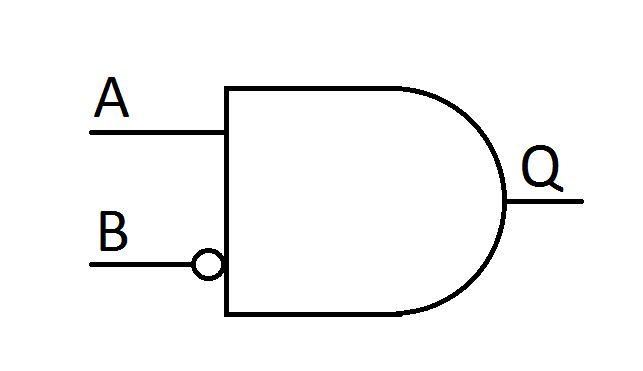

Hello all,
I am trying to learn about electronics and I am attempting to create an electronic circuit that fallows the Q= A AND NOT B logic show by the image below.
In order to do this I figure I should have a AND gate with inputs A, and B. With an inverter on the B input before it reaches the AND gate.
With the risk of looking foolish I am wondering how I can go about doing this. I have found the Inverter and AND gate componets I would like to buy (listed at the end of post) but I am wondering how to attach them to a circuit board for proper use. I know I will have to solder the components to the board but what kind of board should I buy and were can I find one..
Thanks for any help it is greatly appreciated!!
:D
Inverter I want to use = http://http://www.jameco.com/webapp/wcs/stores/servlet/Product_10001_10001_873830_-1
AND gate I want to use= http://www.jameco.com/webapp/wcs/stores/servlet/Product_10001_10001_873725_-1

Welcome to AAC!
Since the parts you have selected are surface mount, you will either have to make a PCB, or find an adapter (they are available).
Just curious, why are you stuck on these parts? They are hard to use, and one you solder them in will not be very reusable.
A through hole set of components and a protoboard are 100% reusable. The book links shown above have some good experiments on the subject.

As Bill noted you want to use DIP type through-hole packages, such as can be found in CD4000 series CMOS digital circuits (Here's a list of common CD4000 circuits). And a protoboard (solder-less breadboard) is any easy way to connect them together.
One Note: Make sure you ground all unused inputs on any CMOS circuits. Otherwise you may get erratic results.

If you wish to reduce your chip count you can do this with a single QUAD 2-INPUT NAND Gate,
one NAND gate and two gates as inverters for B' and Q'. You will have one spare NAND gate.
Yes reducing the chip count is a great idea, I think I see what your saying.. I worked it out on a piece of paper and if I connect the B input to both inputs on one NAND gate and then connect that output to another NAND gate with the other input being from A and then connect that output to both inputs of another NAND gate it will fallow the same truth table.. thanks a lot for the help!
And what you have discovered, more or less, is that any logic circuit can be implemented using only two-input NAND gates (or, it turns out, only two-input NOR gates).
Here's a little exercise to help you explore this. Imagine taking the circuit you started with and changing it so that it was an OR instead of an AND. In other words, what if you had wanted to implement Q= A OR NOT B? Can you figure out how to do that using one a single quad NAND gate package? Hint: You could actually implement two of these circuits that are completely independent. In other words, you only need two two-input NAND gates which makes trying a brute force search of all possible configurations pretty easy.
If you can figure out how to do that, then you have just figured out how to apply what is known as DeMorgan's Theorem. So you might want to read about it in the near future.
