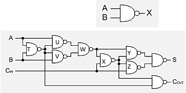

A full adder is implemented using 9 NAND gates as shown. For the NAND gate used, an input change on A will propagate to X in 3.4ps. An input change on B will propagate to X in 4.1ps. Wire delay is neglected.Use 4 set of the full adder design shown to form the fastest possible 4 bit ripple-carry adder! A and B on the NAND gate can be chosen freely in the design. Given that there are registers before and after the adder, each of them driven by exactly the same clock! Delay to and from the registers are set to 0ns.What is the minimum clock cycle-time (maximum frequency), where the adder will work correctly for all input value changes on {A[3:0], B[3:0], CIN} to form the result {S[3:0], COUT}?

Read the problem carefully. It is not enough to just count gate delays, because the NAND gate is specified as being asymmetric. So it matters which side of the gates your worst case path is going through and you can't assume that you can design the circuit so that the worst case path always goes through the fastest NAND input.
Aside from that, you are overlooking something. In the last stage, is the Cout the last thing to change, or the S output?
I would recommend reworking the problem assuming that you have two types of gates, an F gate (fast) and an S gate (slow).

The circuit again:

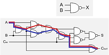

I have revised my approach abit as you said. I have identified the different paths A -> Cout, B->Cout, Cin->Cout and Cin->S can follow.
I’ll use the following notation; UTF means approach gate U from top where top is configured as fast.
Cout is denoted C.
I have designed the orientation of the NAND gates in a way that causes the slowest of all the paths to be as fast as possible.
So looking at the initiation phase (A,B -> Cout) would the following be correct:
RED: A->Cout: TTF - UBF - WTF - XTS - CTF = 4*4.1 = 17.7 ps
BLUE: A->Cout: TTF - VTF - WBS - XTS - CTF = 3*3.4 + 2*4.1 = 18.4 ps
way1 B->Cout: TBS - UBF – WTF – XTS – CTF = 3*3.4 + 2*4.1 = 18.4 ps
way2 B->Cout: TBS – VTF – WBS – XTS – CTF = 2*3.4 + 3*4.1 = 19.1 ps

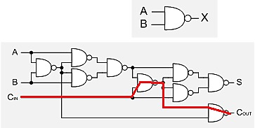

Intermediate phase (Cin -> Cout) times 2
Cin->Cout: XBF – CTF = 2*2*3.4 = 13.6 ps

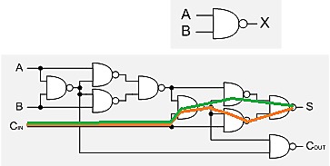

GREEN: Cin->S: XBF – YBF – STF = 3*3.4 = 10.2 ps
ORANGE: Cin->S: XBF – ZTF – SBS = 2*3.4 + 4.1 = 10.9 ps

It looks like you are mostly on the right path, but missing a few subtle things.
For instance, in your initiation phase, for Gate X, you have the Cin signal that goes direct to it and the other signals that take quite a bit of time. So you probably want to put the fastest input to Gate X in the slow path. It is very likely that you want to put it in the Cin path for the intermediate gates because the Cin signal will be delayed heavily from the prior stages. For the final stage you will have to determine which signal has the most delay at Gate X.
Now, an assumption being made here is that you get to assign the gate inputs differently in the different stages. The problem statement doesn't appear to preclude this, but it is very possible that the problem was meant to imply that you get to assign the gate inputs with the full adder, but that you have to use four identical full adders.
My guess, if you have a rational instructor, is that you could do it either way as long as you state what assumptions you are making and show that they are reasonable assumptions given the wording of the problem statement.

I had a very similar exercise last year.
You can state the delay of each NAND gate with logic. For instance, the delay through the gate you marked as T, would be max(A + t1, B + t2) where t1 is either 3.4ps or 4.1ps and t2 is the other. The problem is optimising the t1 and t2 values. If you look the system through, you will find that the first full adder takes 18.4ps to propagate from input to Cout. This only holds true for the first adder, as for the second adder and forth, the delay received from the Cin will greatly affect the output delay.
By the time you reach the fourth adder, you will find that it takes the signal 38.8ps to propogate to the output by my calculations.
