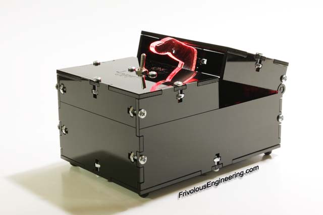

Audioguru: if you need help, please contact me. I'll be releasing schematics, pcb pattern, and laser-cutting templates for version 2 of the machine very soon.
Adding LED's to the machine is very easy, they can be put in parallel with a gear motor. As for current limiting, about 50 ohms @ 3 volts works good for red and green LEDs. If you are going to use 6 volts then 80-100 ohms. Also it doesn't hurt to test things out on a bread-board to find the right value.
Blatant spam: We do have complete parts kits that include a printed circuit board and our machine comes with red and green LEDs that light up the 'actuator'.
http://frivolousengineering.com/
