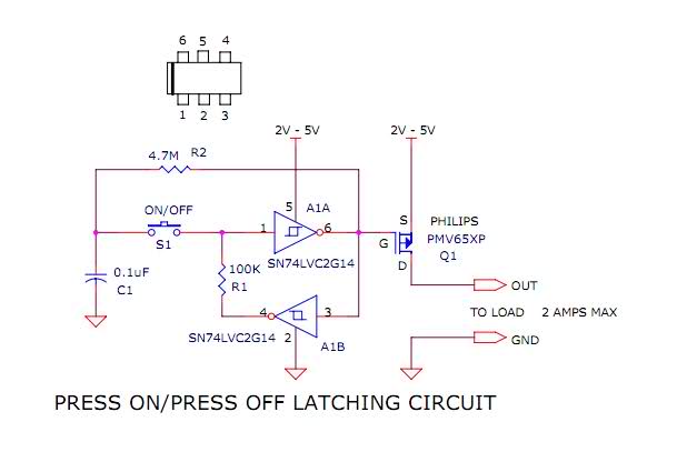

lookie what i found-
this is made by dave johnson submitted to discovercircuits.com
assuming i can find all the parts, this looks easy enough to build and its 1.65-5v
looks like mouser has the dual-schmitt trigger for dirt cheap- http://www.mouser.com/Search/ProductDetail.aspx?R=74LVC2G14GV%2c125virtualkey66800000virtualkey771-LVC2G14GV125
so i got 25 of those coming. everything else that i need i have. this is by far the easiest circuit ive seen yet... i didnt realize at first that is only one logic chip in there.

A CMOS version of my schematic would work at 3.7V. The cap charges to the output voltage, and lasts long enough to trip the TLC555. I can see the standard 555 getting into trouble with 4.5VDC, since its output doesn't go rail to rail. This is explained in chapter 4 of LEDs, 555s, Flashers, and Light Chasers. If you need a drive circuit for the TLC555 let me know, that is the one aspect of those chips that is a real PITA.

honestly im really liking this dual-schmitt trigger circuit. just add 2 resistors, a cap and a mosfet and youre done. i ended up ordering the exact parts listed in the diagram, because after comparing datasheets for hours the ones listed really are the best fit for what i want. i was tired of spending the 1200% ratshack tax too.
basically, this circuit with those parts is good for 1v min -12v max signal on the trigger, a 20v spike protection overall, 2A+ constant sink current, and switching as fast as you can push. you can buy all the parts shown at mouser for about $1. of course, there is shipping to, so i bought enough parts to make 15 of these for $17 shipped
