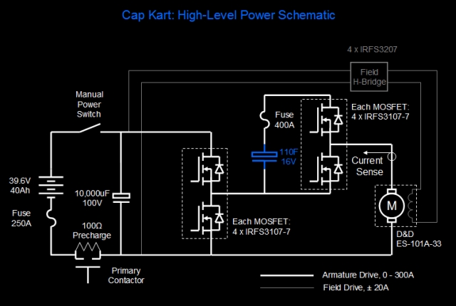

have an idea for a circuit:
60 ultracapacitors and 26 6 volt deep cycle batteries in an electric vehicle
can these be placed all in series?
C = Ultracapacitor
B = Battery
Motor - Controller -(60 C 2.7 vdc each 160 vdc) - ( 26 B 6 vdc each 156 vdc))
This type of circuit is already in an electric vehicle but the capacitors are in parallel with the batteries.

the ultracapacitors would take the initial power drain (600 amps DC) when the vehicle starts from zero mph. the batteries should be able to fill the caps as they drain, the capacitance of the capacitors is 50 farads. they are 3000 farad maxwell ultracapacitors. the ESR of the capacitors is a total of 17.4 milliohms.
from these numbers I believe as the capacitors drain at 600 amps the batteries will be filling the ucaps back up. at 17.4 milliohms the batteries would be able to fill the caps and not see over 200 amps.
the purpose of this circuit is to eliminate the peukart effect on the batteries and to eliminate the voltage sag. this should make the batteries be able to deliver the maximum amount of rated amp hours, in this case they are 235 amp hour batteries, and have a longer lifespan.
the batteries in this case are lead acid. the goal is to give the EV more range and make the batteries have a longer lifespan.

You have a series circuit, so current in any part must be the same in every component.
Placing capacitors of any sort in series with batteries feeding a motor will effectively block the DC current (that's part of the definition of a capacitor). Your action
is very close to perpetual motion. If the motor needs 600 amps, then something has to provide that level of current.
This can be a very simple experiment to conduct with some loose batteries and some capacitors. See what happens with the capacitors in series with the batteries. Then in parallel. If you have a meter, you can watch current and the voltage sag. Arranging a load on the motor will exaggerate any effects.

You say the battery will fill the caps back up. Think about that and then describe to me where the energy will come from to provide 'extended' range.
The batteries are a source. The caps are simply storage. They can provide nothing more than what they are given from a SOURCE.
If you do not provide MORE source capacity the battery will not extend range even one inch.
Improving 'efficiency' of the torque producer(the motor). Creating an environment in which energy from the source is utilized more completely. Resulting in increased range FROM THE SAME AMOUNT OF ENERGY. Your previous post seems to be saying that you think the caps will increase the batteries amp hours. Nothing but more/different batteries will change the amp hours of the battery.
13,277
Doesn't look like a series circuit to me.
It's not parallel, look closer. The 150F 16V cap is in series until discharged then it's turned off and bypassed by the right set of SSRs for battery power. The first set of SSRs on the left select the battery power or place the Ultracap in parallel with the motor for regen brake recharging.
this is the way I wanted to build the circuit. the capacitors are in the circuit till drained then removed before they reach zero. they are filled back up with regen then reinserted into the circuit after recharged. for the currents I am using the controllers to do require more budget then I have. Ill be looking into it after the vehicle is finished.
For now I must choose between placing the capacitors in series versus placing them in parallel.
the batteries only have a certain amount of energy yes, but the peukert effect and voltage sag reduces that energy before it gets to the motor. a battery rated for 235 amp hours under heavy discharge will not deliver 235 amp hours. if we remove the peukert effect and the voltage sag from the equation we get more efficiency and thus more range. the same amount of energy is there, i am just trying to get more energy to the motor and reduce the losses from the energy storage to the actual use of the energy.
this can be compared to gasoline engines. there is a set amount of energy in the gasoline. if you can make the engine more efficient it will be able to use more energy from the gas to go longer distance. increase miles per gallon get more distance. for electric vehicles, reduce the amount of watts per mile used and increase the range.
It looks to me like it is contrable depending on settings for the MOSFETS, it can be in 3 configurations
1) Caps supply energy for motor
2) Batteries supply energy for motor
3) Caps & Batteries are in series to supply motor
Looks like versitle routing setup, but not sure the series setup would do much as the current would be same through all components. Maybe if the batteries were low and you pull the regen from braking into the caps, the extra voltage capability would provide boost for low battery, but would drain very quickly. Will be interesting to see how the MIT team uses it.

Just like Kermit2 said the capacitors being charged from the BATTERIES is not going to help. They are still being charged by the batteries, still giving the same 'peukert effect.' You must charge the capacitors from a different source (regen braking) to make any difference in the end amount of energy expended.
Your not going to get a different answer here than you did over on the Electro Tech Online site. The same laws of Physics apply here. Like they told you, go to an 'over-unity' forum to hear anything different.

the question I am trying to get is what will the batteries see as far as amperage charging the capacitors actually equalizing with the capacitors once the capacitors are drained and have yet to get an answer.
You may be having that problem with an answer as it is close to impossible to parse that sentence.
Can you draw up a diagram of your battery and capacitor arrangement?
13,277
I know the batteries will still be charging the capacitors but not at 600 amps. the question I am trying to get is what will the batteries see as far as amperage charging the capacitors actually equalizing with the capacitors once the capacitors are drained and have yet to get an answer.
maybe because the answer cannot be calculated? that would make sense.
With the capacitors in parallel with the battery you can never fully use most of the energy in the cap because as soon as the voltage drops to the the battery loaded voltage the battery will supply almost all the current then. Only in a 'Pulse' demand system of usage will the capacitor provide any cost-effective advantages over just a battery only.

Putting 2 capacitors in series halves their capacitance (and doubles the breakdown voltage), and it only gets worse when you add more capacitors.
The point of the battery taking over when a capacitor is discharged below the battery value is also a good one. Both batteries and capacitors are storage devices, but the battery is a constant voltage (relatively), while a capacitor is not (look up RC curves).
There is an effort to use capacitors as batteries in cars. There are technical issues, it is far from perfect, but it could be solved eventually. The cap is charged to over 10 thousand volts, and the charge is slowly metered out via electronics. I can hardly wait for the technical questions on that mess on this site. Google eestor.

To get 600 Amps out of the capacitors, you have to put more than 600 Amps into them. The battery doesn't know whether it is charging the capacitor or turning the motor, it's still it's using power to do it.
The boxvan and the EV1 both were charged from a outside source, Not the on-board battery.
You can't get something from nothing.
