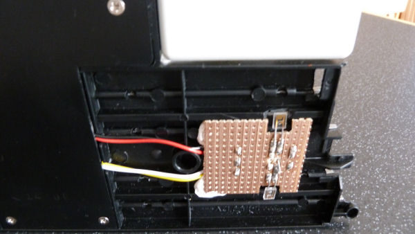

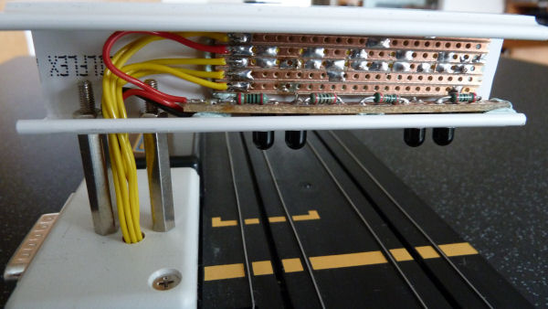

Car sensing is done by IR beam breaking with a pair of IR LEDs over each lane and an IR opto transistor under each lane with a small cut in the plastic track.
The output from the opto transistor is cleaned up by a simple comparator based threshold detector and this is fed into time inputs on the PIC.

Track Mounted Unit
LEDs and opto transistors are mounted on vero board. Five forward facing start LEDs and four downward facing IR LEDs, two per track. These are mounted in a length of plastic wiring conduit (the type with a detachable lid and self adhesive backing).
