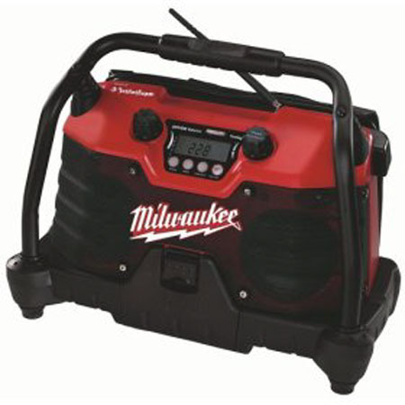

I have two Milwaukee Job Site radios.
I just bought an 18V lithium ion tool kit. I have an extra charger with that kit that I required for free.
The new Milwaukee battery design does not fit into the old radios that I have.
And obviously, I want the battery to fit into it. And while I'm at it, I may as well install a charger into the radio as the radio itself will not charge batteries but only consume them.
The radio uses 12-28v batteries of the older design. But I don't own any of the older batteries/tools. So again. This is why I am converting this radio.
First things first, I made sure that the radio would run off the new 18v Li-ion battery, and it did! So I began modding. I even made enough room for the charger in the radio and installed it. I then modded the charger bay to holster the new battery size and terminals. I then decided to try the radio again to see if it worked. It didn't. After many frustrating minutes of trying to figure out why, I figured it out. I tested it with a different battery than I previously tested it with. A fully charged one. The one I used before was about 50% charged (going off the digital bat meter on the battery.) I even decided to try it with a 12V battery from a different tool brand, Hitachi. It works beautiful.
I just want to know why and what I can do to make the radio work with a fully charged battery. I'm assuming it's the amps. The amps on the new 18v battery must be higher than the old batteries were. I figured that I wouldn't have to do anything. As the radio is designed to accept 12-28v batteries. I was thinking of using some kind of resistor or even a voltage regulator. I just don't know what to do. This is where I need help.
What the radio does with the fully charged battery. It runs for a few seconds then it cuts off.
I'm just doing this for fun. Its an outside (water resistant design) radio. And I have two of them. If it blows up... It blows up
I would just appreciate being able to work with a cordless radio once in awhile. Then to be able to charge my batteries without having to remove them from the radio.
I have everything else working except the problem of fully charged batteries not working with the existing radio's battery input lines. Help me if you can.
