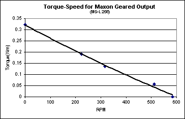

Markd77
Joined Sep 7, 2009
2,806
This is the curve for a normal DC motor. The induction motor is being driven at the frequency at the far right side of your graph. The Full load speed is for maximum power output and maximum power does not occur at maximum torque because power is proportional to speed X torque.
For the DC motor maximum torque is at zero speed and although the motor is using a lot of power, the mechanical power is zero, because it is not doing any work.
