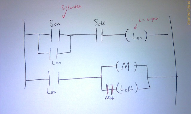

Hey guys I have a question that is confusing me.
It is mentioned that the N.C -[/]- (normally closed) contact is similar to a Logical invertor (NOT).
How is a --|NOT|-- similar to a --[/]-- contact ?
Can someone please explain this with diagrams ?
Thank you very much !!
I am asking this because I want to know if this model is correct :
Son = On Switch
Soff= Off Switch
Lon = ON light
Loff= OFF light
M= Motor
The on switch should turn on the Motor and ON light. The off button should turn off the Motor and ON light, AND turn on the OFF light.
I have a mistake in the picture, the Soff should be N.C --[/]--

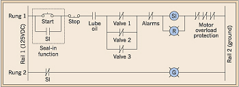

Look at this ladder diagram
We have on input switch S1 and two output lights.
When S1 is ON [1] then L1 [1] is ON ans L2 OFF [0]
And when S1 is OFF [0] then L2 is ON [1] and L1 is OFF [0].
And in your diagram you have two switch or only one switch?
And two lights ?

Yes I have two switches and two lights :
Son = On Switch
Soff= Off Switch
Lon = ON light
Loff= OFF light
M= Motor
Is my ladder diagram correct ? or is it wrong ?

I think it will be something like this
Reply With Quote

Can you please explain the sketch ? does that mean there are more than 2 buttons ? there is an Son and Soff in the first rung, and the same in the second rung !
And does that mean my ladder model is incorrect ?
Thank you very much.

No there is only one Son and Soff switch connect to PLC controller.
This schematic is a internal PLC "virtual diagram".
http://www.allaboutcircuits.com/vol_4/chpt_6/6.html
And in your ladder diagram to "ON" the Lon, the Son and Soff must by ON.

So your model is correct, right ? So I can assume mine is wrong. Can you tell me where is the mistake in my model ?
Thanks

You put Son is series with Soff.
So to light Lon the Son and Soff must be ON (1).
