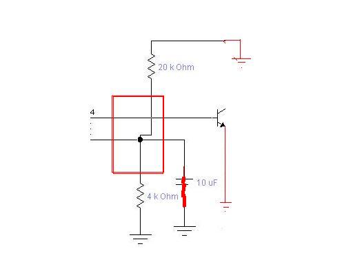

But there's still one thing I'm really confused...
Looking at the picture, when the capacitor is shorted to ground, will it not bypass the 4k ohm resistor?
If that's the case, i think it should not be a part of the re model in the ac analysis. (I mean isn't that the loading for the secondary is just 2k||20k?)
But the picture and the situation is really confusing, please help me figure this out.
You're quite right. I overlooked that point. It's a way to avoid the AC loading effect of the bias divider that can only be done this easily with a transformer.
Neither the 4k nor the 20k appears as an AC load on the base circuit, so you just leave then out of the calculations.

Thank you for the quick response. So you mean that the loading for the secondary of the transformer is just 2k? The Bre? But at one more glance, i think the 2k Bre is also bypassed, the problem is very confusing.
By the way, are my calculations correct? The one I posted before. (I have included the 20k and 4k in my calculations)
The 2k Bre is not bypassed, because it's connected to the top of the secondary, whereas the bypass capacitor is connected to the bottom. Since the 4k and 20k are connected to the bottom where the bypass capacitor is, they don't appear as an AC load at the transformer secondary.
Anything which is connected to the bottom of the transformer secondary is connected to AC ground. Anything connected to the top of the secondary appears as a load on any AC signals applied to the primary.
sorry, I have just read your post. It took me a while making my last post. Thanks! Everything is clear now! Thanks a lot. Now I can solve these types of problems confidently. :D
