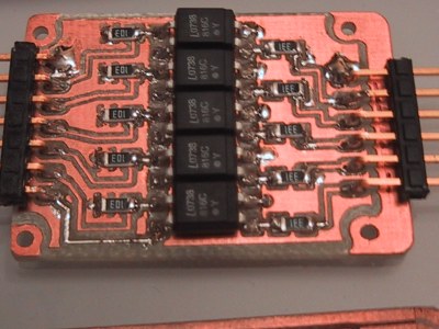

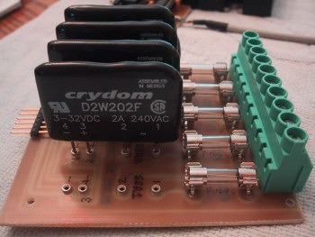

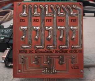

Here is an example (I built it) of how SSR's would be in a "real world" circuit.... with the kind that you have, it is too large and bulky to be placed on a PCB or in circuit, those are designed more for running wires to and from them.....
and sometimes they can be smaller.....
My .02
