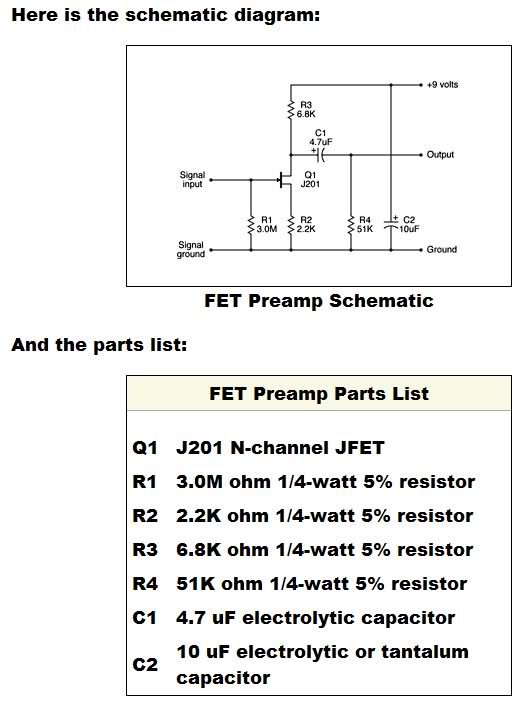

The thing is, I found a preamp design that I like, but it doesn't have tone controls.
I guess it's one of the more popular preamps over the years, and it looks pretty easy to build.
http://www.till.com/articles/GuitarPreamp/
So i'm hoping to either be able to incorporate tone controls with that, or maybe one in series with it.

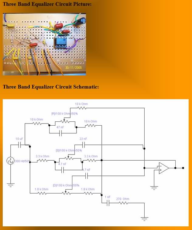

Would this EQ be able to work with that?
They both require voltage, so would there be any way to put them on the same circuit?
beenthere
Joined Apr 20, 2004
15,819
That circuit should work. Use a better op amp, like an OPA134, though.
I can't quite make out - - who "they" are.
By the way, the above circuit and my tone control example both require a dual power supply - positive and negative voltage.
I meant the preamp I posted on the last post of the first page and the EQ from this page, both being powered.
I was thinking about adapting the actual EQ circuitry into the preamp from the first page. It seems like that FET circuit is really ironed out.
But I suppose it's pointless since the EQ is powered as is.
So I wonder how hard it would be to add a variable Q to the midrange eq circuit?
Oh, and the opa134 can also run all 3 midrange channels?

Audioguru
Joined Dec 20, 2007
11,248
An LM358 is horrible for audio.
An OPA134 is an excellent single audio opamp. The OPA2134 is the dual and the OPA4134 is the quad.
It is easy to bias the input of the EQ opamp at half the supply voltage so it can be powered from a single-polarity supply.
They stopped making the LMC835 EQ IC about 10 years ago.
