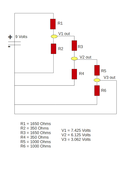

Would this work? I'm a newbie and I saw a voltage divider schematic in one of my books so I figure I would drawing this up. It's untested.

What you have there is a voltage divider...as you said. It is not a row of power supplies. Now...if you had a power amplifer attached to each of the voltage out places, it would be a row of power supplies. The easier and better way is to buy the regulators that externet spoke about. They supply power without resistors becoming part of the load or interfering with keeping a steady voltage.
The answer is an unequivocal no. By the way... V3 would = zero as R6 is shorted.
Voltage dividers are most useful and used mostly where infinitesimal current is drawn from any of the nodes. They simply do not lend themselves to good power distribution. In other words they don't posses Voltage vs Current stability. Besides that, when used to distribute power they're lossy as hell. Might be good to heat your room with though! :rolleyes:
Back in the 'Old Days' it was not uncommon to encounter voltage dividers because Vacuum Tube circuitry were voltage amplifiers, where plate currents were relatively low, except for the driver & power amplifier stage.
