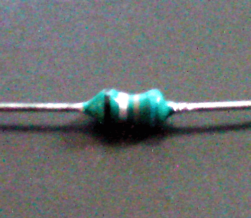

I got a lot of air-inductors laying around (multilayer) But I don't have any equiptment to measure them with. (They are all from a amplifier)
Here is a picture of them I got from futurlec.com - Is it that type I could use?
The Electrician
Joined Oct 9, 2007
2,986
Jep, it's 0.68uH, but is it usable for my project?
What is its DC resistance? Be careful about measuring with a DMM. Short the leads of your DMM while on the ohms range, and get the resistance of the leads. Subtract that value from the measured resistance of the inductor.

Ok thanks.
If it says 0.68 uH why not?
They are a bit uncommon though.
Wire resistance even for small RF inductor will be small at 0.68uH
Its not air coil. These are called color wheel RF inductor or just RF inductor.
There are 4 different sizes
1/8W quite uncommon
1/4W more common
1/2W mostly this kind is found
1W very uncommon for DIY but used in commercial appliances.
